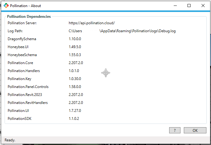

### About
Use the About button to see the information about the libraries installed in the Revit plugin.
<figure><img src="https://2884583650-files.gitbook.io/~/files/v0/b/gitbook-x-prod.appspot.com/o/spaces%2F-MaZZSUE1L_iKrqfreV9%2Fuploads%2Fgit-blob-828b7cd6c420100b10e7e0e95d7b17fd9a1d72ad%2Fimage.png?alt=media" alt=""><figcaption></figcaption></figure>
