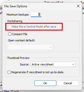

## 1. Save the host model as a Central Model
The first step in the process is to ensure you open the model with the rooms, areas, or spaces as the host model, and save the model as a Central Model. You can see if the model is already saved as a Central Model in the `File Save Options` menu.
<figure><img src="https://2884583650-files.gitbook.io/~/files/v0/b/gitbook-x-prod.appspot.com/o/spaces%2F-MaZZSUE1L_iKrqfreV9%2Fuploads%2Fgit-blob-e39633b3239cdb543d99c7101ea08f7c11222682%2Fimage%20(175)%20(1).png?alt=media" alt=""><figcaption></figcaption></figure>

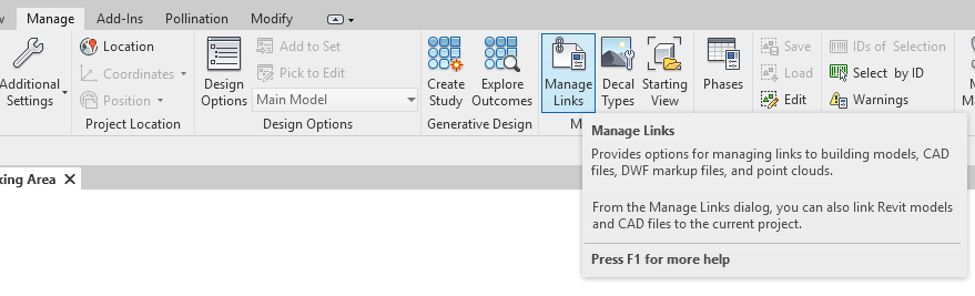

## 2. Review the linked Revit models
Ensure all the other Revit models are linked to the host model correctly. The `Manage Links` button is under the Manage tab in Revit.
<figure><img src="https://2884583650-files.gitbook.io/~/files/v0/b/gitbook-x-prod.appspot.com/o/spaces%2F-MaZZSUE1L_iKrqfreV9%2Fuploads%2Fgit-blob-71ec1cd646e04685f738528151eeb356097585b1%2Fimage.png?alt=media" alt=""><figcaption></figcaption></figure>
