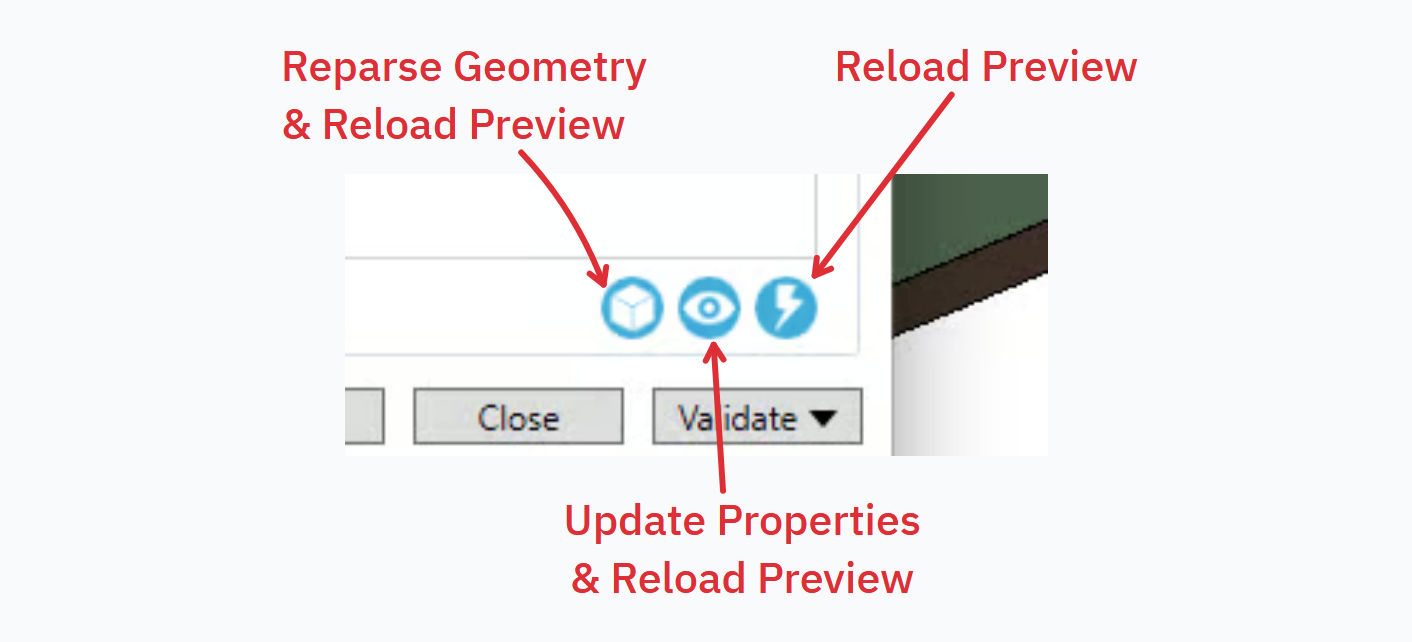

Pollination provides 3 different preview options.
<figure><img src="https://2884583650-files.gitbook.io/~/files/v0/b/gitbook-x-prod.appspot.com/o/spaces%2F-MaZZSUE1L_iKrqfreV9%2Fuploads%2Fgit-blob-1091a6cecf069c6561e6b90956ddcbe06f8eba42%2Fimage.png?alt=media" alt=""><figcaption><p>3D Preview Options</p></figcaption></figure>
Starting from right to left:
1. Reload Preview: This button creates a preview of the selected rooms based on their latest properties.
2. Update Properties & Reload Preview: This button updates the room Pollination properties, such as "Height" and "Is Top Exposed," before generating the preview. This option is slightly slower than the first option, and should only be used when you have made a change in any Pollination properties.
3. Reparse Geometry & Reload Preview: This button re-parses the selected rooms from Revit before generating the preview. This option could be much slower than the other two options, and should only be used when there has been a change in the Revit model (such as editing the room boundary, or windows/doors selection) or there is a need to re-parse the room because of changes in Pollination properties. For example, when the room height is changed and you need to re-parse the room to project the windows based on the new height.
