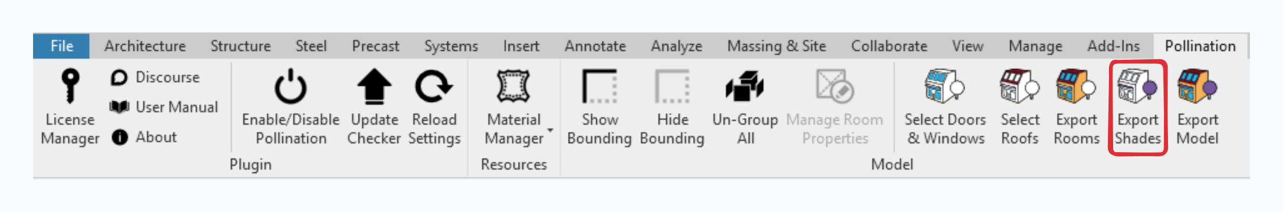

To start exporting shades as a Pollination snapshot, click on the Export Shades button.

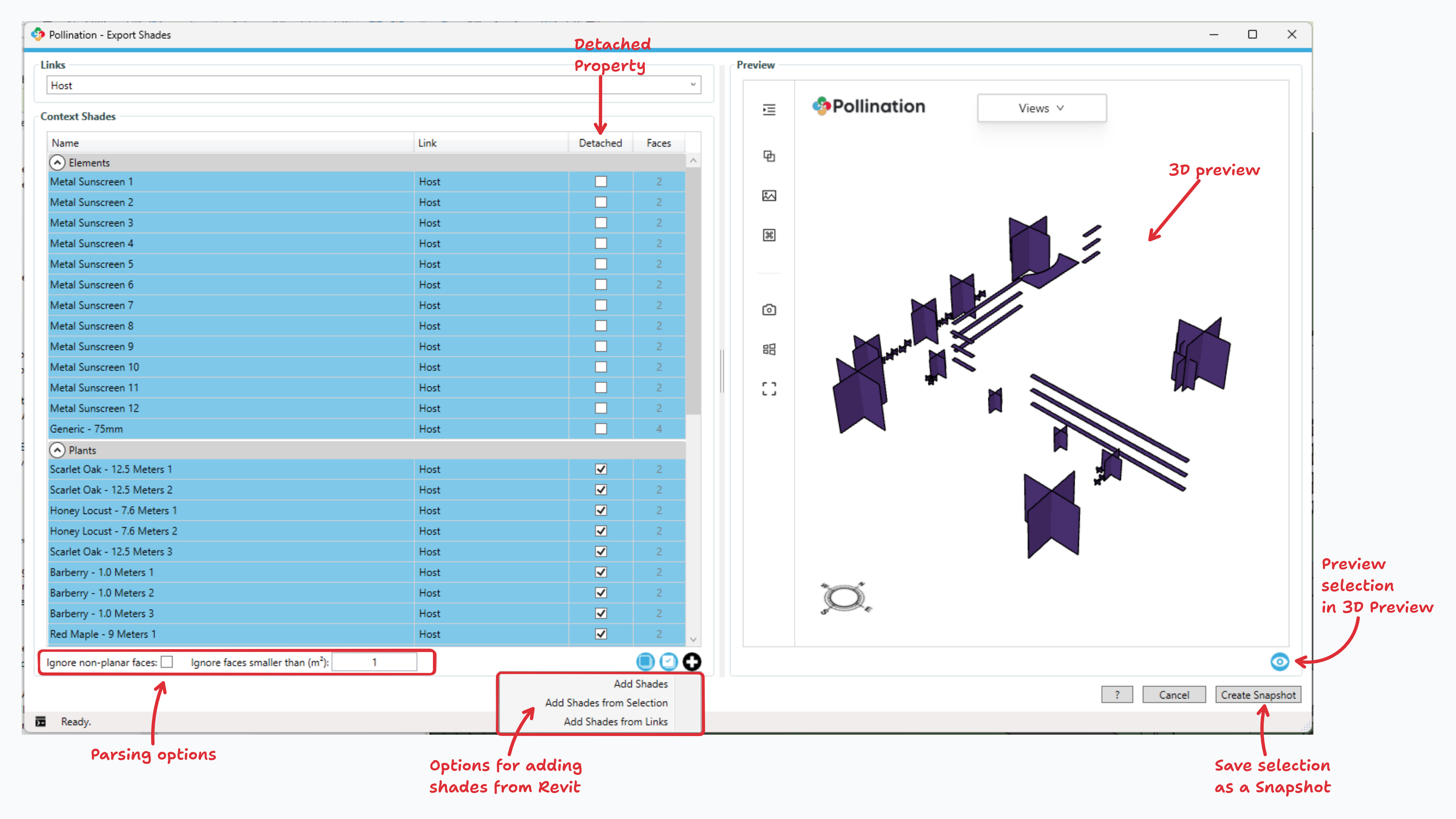

The button opens up a menu that allows you to select Revit elements and export them as shade objects in an energy model. Like the "Export Rooms" menu, you can visualize the shades in the UI before exporting them.

There are 3 options for adding elements as shades:

Shade elements can be attached to the building (such as window overhangs) or detached from the building (such as neighbor buildings and trees). Use the "Detached" property in the table to indicate if the shade is attached or detached from the building.
This property only translates to DFJSON, HBJSON, and GEM file formats. Attached shades translate to local shades in IESVE.

The Export Shades menu provides two options to control the export process.
<figure><img src="https://2884583650-files.gitbook.io/~/files/v0/b/gitbook-x-prod.appspot.com/o/spaces%2F-MaZZSUE1L_iKrqfreV9%2Fuploads%2Fgit-blob-517835ab04968b5cc4c89c7a831bfe41016c93e1%2Fimage%20(177).png?alt=media" alt=""><figcaption></figcaption></figure>
### Ignore non-planar faces
Use this option to ignore the non-planar faces in the selection. By default, the Pollination plugin converts non-planar faces to several planar mesh faces.
### Area filter
Revit models can include many details that are "too much detail" for energy models. This option helps you filter out these small geometries. The default value is 1 m<sup>2</sup>.
