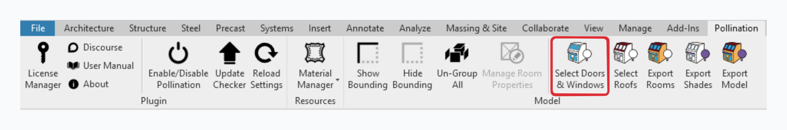

To select windows and doors families, click on the `Select Doors & Windows` button.
<figure><img src="https://2884583650-files.gitbook.io/~/files/v0/b/gitbook-x-prod.appspot.com/o/spaces%2F-MaZZSUE1L_iKrqfreV9%2Fuploads%2Fgit-blob-7dbdf386629de7990ffc11b00eae2c9798a3ca93%2Fimage.png?alt=media" alt=""><figcaption></figcaption></figure>
