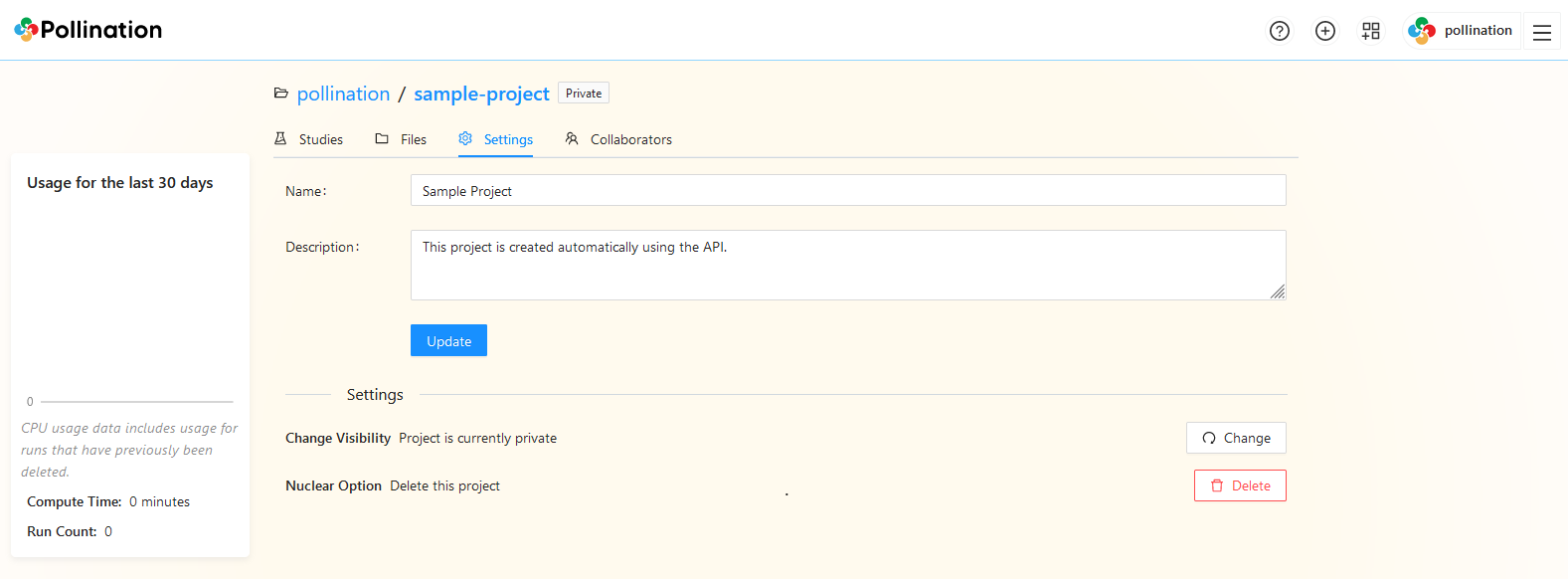

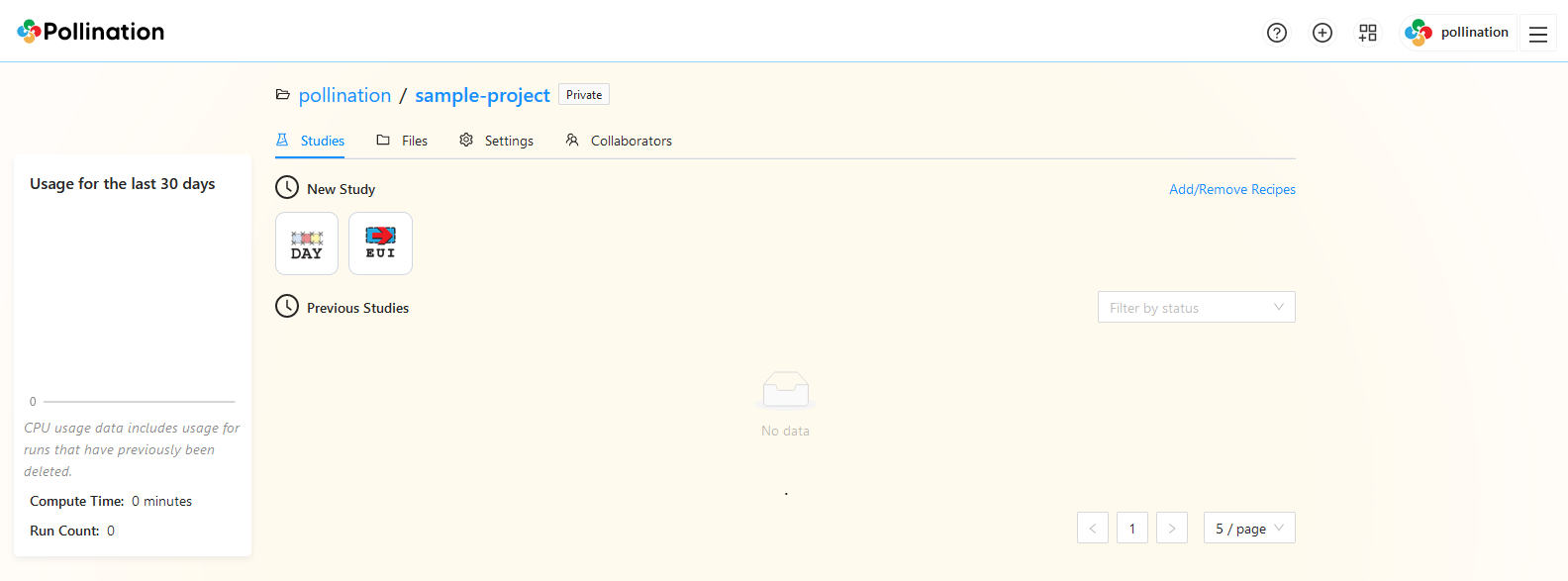

Here are the screenshots of the project created using the sample code.
<figure><img src="https://2884583650-files.gitbook.io/~/files/v0/b/gitbook-x-prod.appspot.com/o/spaces%2F-MaZZSUE1L_iKrqfreV9%2Fuploads%2Fgit-blob-6b645e85d253578e19a8b572e1f1a50e9f2fe641%2Fimage.png?alt=media" alt=""><figcaption><p>Project landing page</p></figcaption></figure>
<figure><img src="https://2884583650-files.gitbook.io/~/files/v0/b/gitbook-x-prod.appspot.com/o/spaces%2F-MaZZSUE1L_iKrqfreV9%2Fuploads%2Fgit-blob-8ef8197b6df0bd04a62ca2a022d38f634e5a18e6%2Fimage.png?alt=media" alt=""><figcaption><p>Project settings</p></figcaption></figure>
