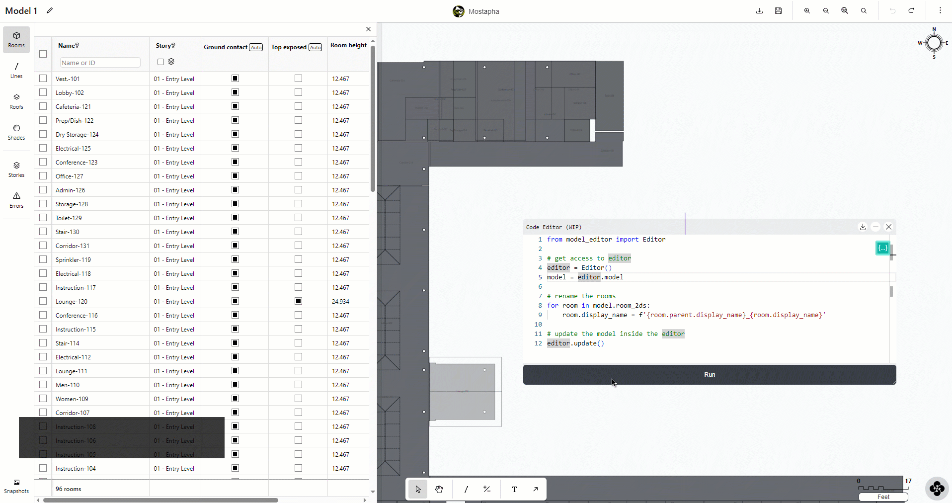

<figure><img src="https://2884583650-files.gitbook.io/~/files/v0/b/gitbook-x-prod.appspot.com/o/spaces%2F-MaZZSUE1L_iKrqfreV9%2Fuploads%2Fgit-blob-572a0907432889bcdda58eea5f2f27036d9f0e17%2Fyour-first-script.gif?alt=media" alt=""><figcaption><p>Running the code from inside the Model Editor</p></figcaption></figure>
Here is what the full code looks like.
```python
from model_editor import Editor
# get access to editor
editor = Editor()
model = editor.model
# rename the rooms
for room in model.room_2ds:
    room.display_name = f'{room.parent.display_name}_{room.display_name}'
# update the model inside the editor
editor.update()
