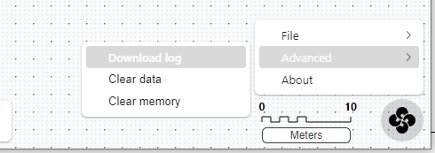

The best way to get help is to open a new topic on [Pollination discourse](https://discourse.pollination.solutions/). You should provide enough information including an explanation of how to recreate the error message and screenshots of the error message and the logs. You can download the logs by clicking on the Pollination logo at the bottom right corner of the screen and selecting Advanced > Download logs.

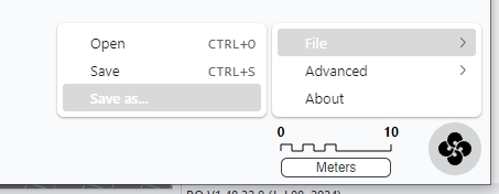

In some cases, we might ask you to share the model or part of the model with us for debugging. Use the SaveAs option to save the model as a PoMF file.
